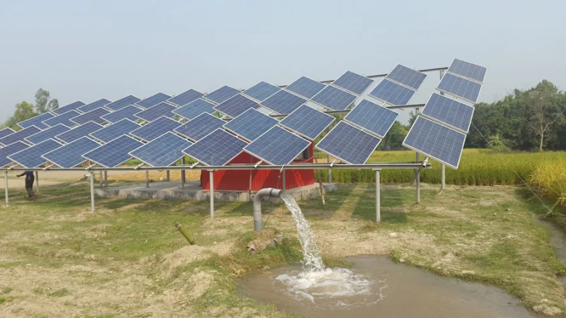

Currently, the existing on-grid installed capacity of solar power is 367.81MW. There are 550MW solar park projects committed; all are at the implementation stage. The 200MW solar power plant in Gaibandha is operating on trial. Although there are more at the planning stage, there is little understanding of whether they will be implemented or not.
