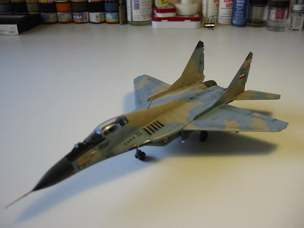

@Sharma Ji @Bilal9 check this. Baaz urf Fulcrum
Love the finish, brother man. Award winner for sure....
Though I'd say, I couldn't make out any super-detailing or dropped flaps etc. Not that it's needed.
Out of the box, the shape is super accurate (nose cone especially) - and so are the colors.
I don't think you used the Hasegawa kit parts, did you? That one is a dawg. Italeri was far better.
Any resin parts used?
Fukk it’s been hard doing so much scratch building with plastic and straws and old credit cards needles and putty….endless hours of sanding and shaping……well I guess it keeps yous busy no…..
The S-136 is 3D printed. The Meraj-532 has wings from a 3D printed S-129 but the rest is all being scratched by hand.
Italieri had the best Fulcrum for a while. Now the Zvezda ones the top dogs on accuracy. Both the 9-13 and the 9-19 (Fatback).
I used the Pavla resin cockpit set and almost always use Gunze Acrylics.
Weathering always with inks and pastels after a 'future' clear coat.

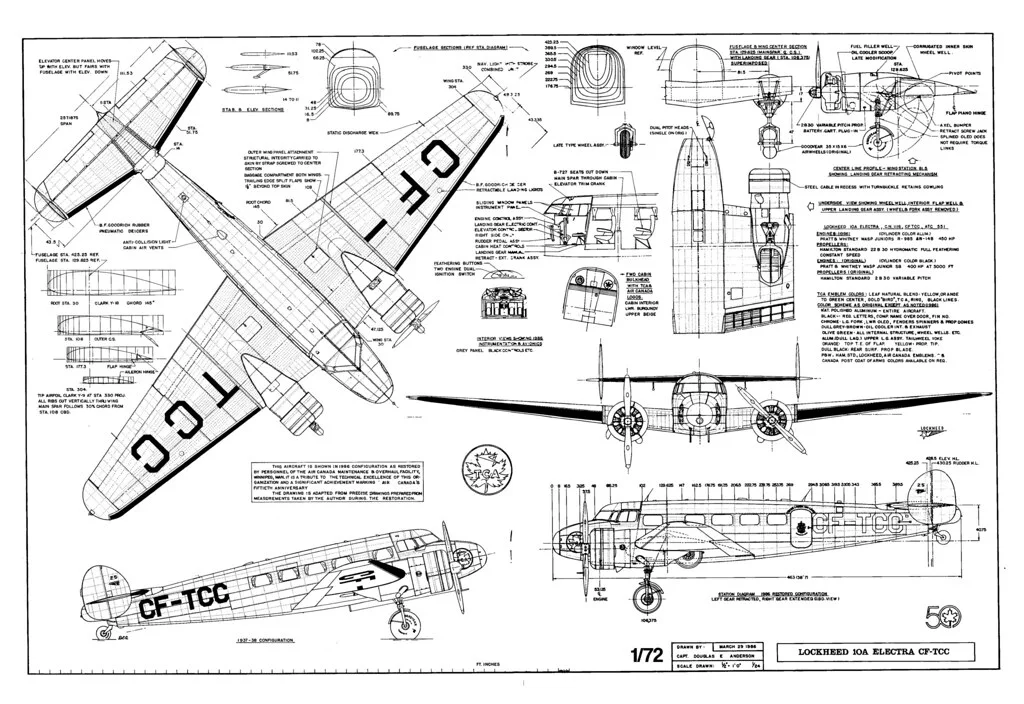

Well whaddya know - almost identical interest with mine. I like Pre ww-2 (interwar years 1930s) light commercial aviation as well. Especially the Lockheed electra 10/JR/12/14 stuff. These have some sleek lines, designed by Kelly Johnson of SR-71 fame. Whatever looks good, flies just as good.
  • Reg: F-AZLL photos
  • Aircraft: Lockheed 12A Electra
NC18906 S/N 1277, N18906
Aircraft: Lockheed 10 Electra (a bit smaller than the 12A model above)
Special Hobby has a kit for the 12 model (and also for the 10),
The Zvezda 1/72 MiG-29 9-13 was confirmed as a re-tooled (corrected) Italeri mold, that's how good the Italeri mold was from the 1990s.
I bet the same with the Zvezda 9-19 mold.
Future floor polish is now out of the market in the US (don't know about Japan), I still have a couple of bottles from when it went away a few years ago, almost out now. But there are alternate products.
I also weather but 'subtle' is the name of the game. You can use diluted black fountain pen inks to weather, mixed with 91% alcohol. The pigment inks (instead of dye-based ones) work better on the engraved lines, but have to be careful about applying the engraving ink with a fine nib. Very dilute Ink wash, cleanup then highlight the sun-burnt areas with lighter-toned paint. Works great with military stuff and some older civilian airliner type stuff as well.
