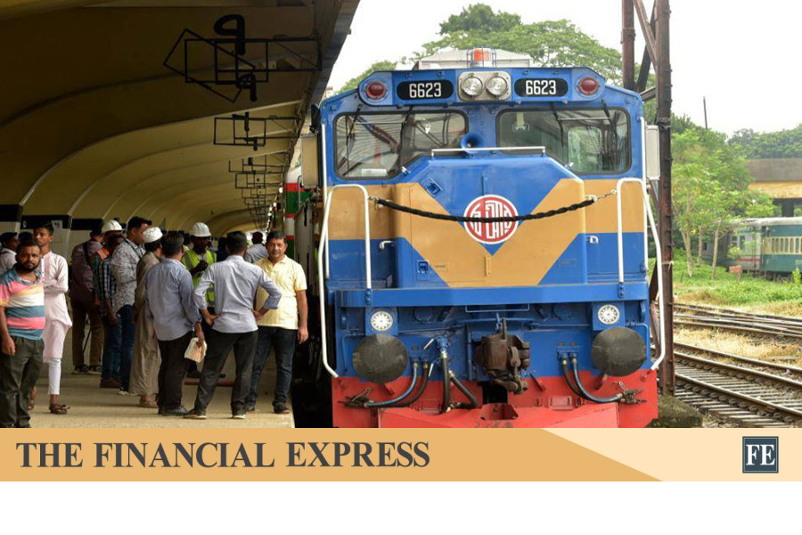

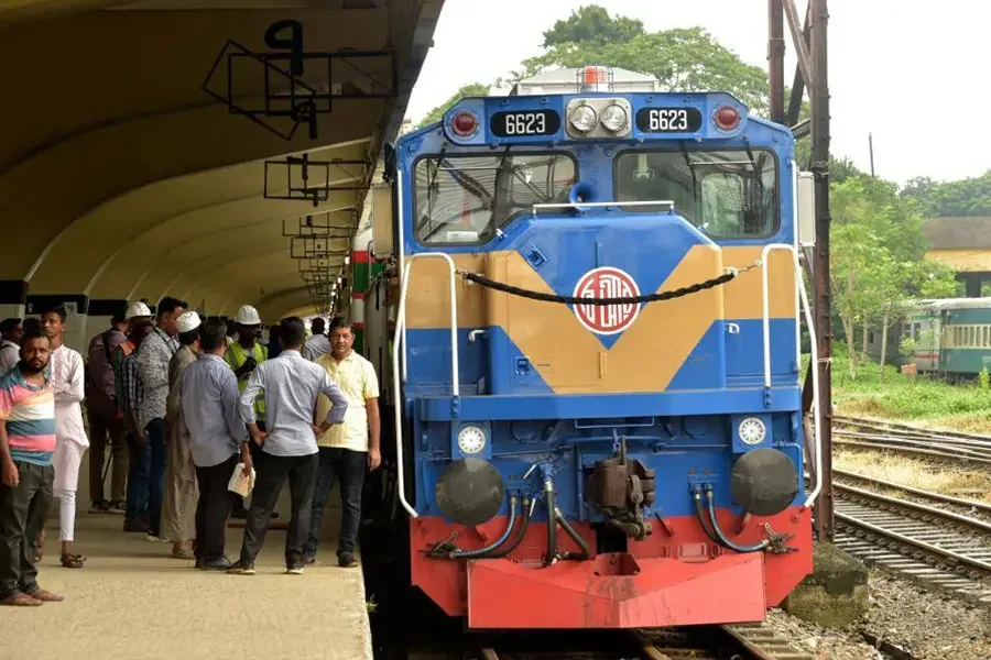

The urgency is difficult to ignore. An investigation published by a local daily on October 15 reported that 18 of 30 relatively new Hyundai Rotem locomotives had become inoperative within four years of entering service, partly because of unavailable spares and technical support. According to the same account, only two of eight container trains were operating regularly. Eastern Zone container-train trips fell from 2,878 in FY2022-23 to 1,467 in FY2025-26. This undermines the reliability traders require.
The government has responded. On October 7, ECNEC approved a Tk 2,769.86-crore project to acquire 30 additional metre-gauge locomotives, with implementation scheduled through December 2029. Procuring these engines is necessary: the eastern network still depends on metre gauge. But new purchases cannot repair existing engines or guarantee early delivery. The long procurement horizon creates a compelling case for a parallel operational strategy.
