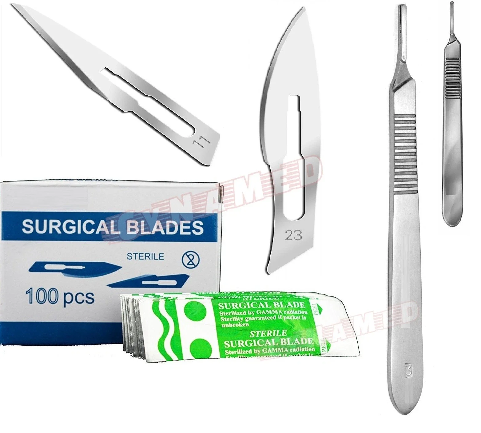

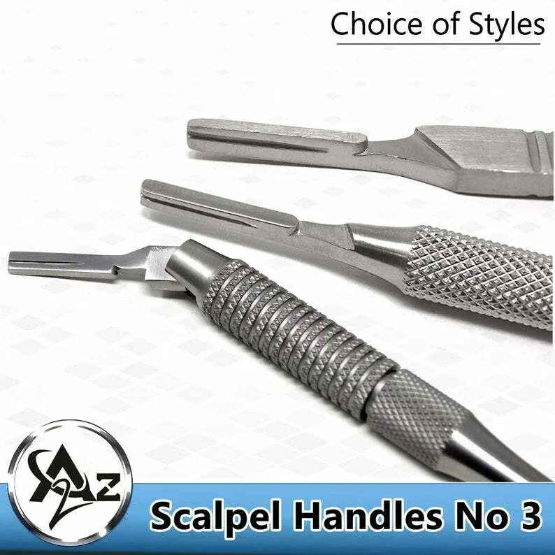

Surgical instruments like scalpels are wonderful substitutes for X-Acto knives. Scalpel handles come in many styles. I have all of these in dozens, they are all made in Sialkot Pakistan.
Among Scalpel blades, they come in two sizes (handles to fit the blades are two sizes as well- large and small) and each of these have numbers assigned. In my use, Nos. 23 and 11 have been the most useful (nos. are imprinted on each blade and these I believe are larger size, please check), the former No. 23 for general whittling and carving. Any medical surgery supply house in India will have these. Chinese blades are sharp enough, but in India test first. In the picture below see the two sizes of handles.

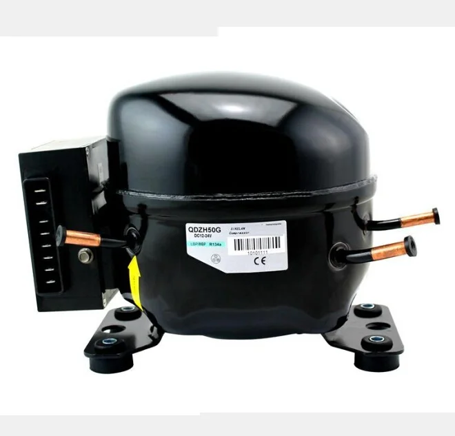

For a newbie like you - choose the Chinese 180T airbrush made by a brand called Fengda. It is a copy of the Japanese IWATA CM Micron and should cost around 20 Quid (pictures below). Great results for not a lot of money. Airbrushes are finicky as they need proper cleaning before and after each painting session. Also paint needs to be diluted properly to run through the airbrush. You need a compressor to have air pressure for the airbrush. Some workshops in India make these from old refrigerator compressors. Picture below.
yes, compressors walas are next level.. im thinking just manual spray walas for now.
