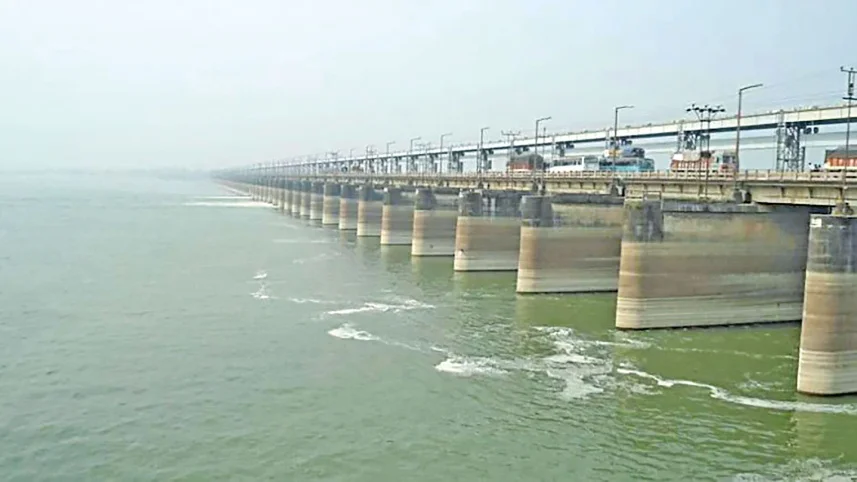

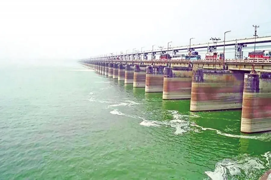

Farakka barrage File photo

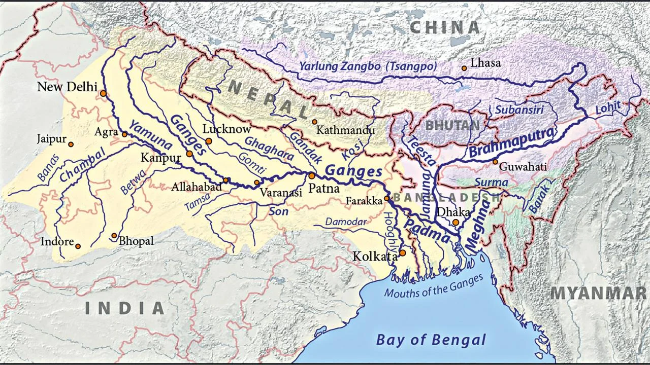

Ganges-Brahmaputra-Meghna (GBM) Basin

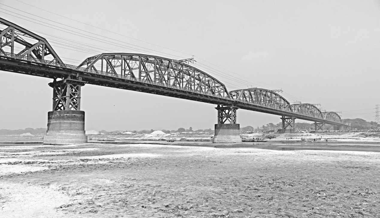

India’s withdrawal of water during the dry season leaves the riverbed near Hardinge Bridge almost dry. File Photo: Humayun Kabir Topu
