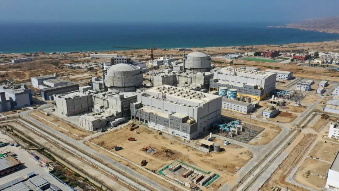

Chashma 5
In November 2010 the PAEC signed a construction agreement with CNNC for a fifth unit at Chashma. In February 2013 a further agreement was signed by PAEC with CNNC for a 1000 MWe unit at Chashma. It was reported that China expected that this deal would be controversial under the Non-Proliferation Treaty (NPT) and guidelines of the NSG. Early in 2013 CNNC confirmed that the reactor would be an ACP1000 unit, though not necessarily at Chashma. In November 2017 CNNC signed a cooperation agreement with PAEC on the construction of Chashma 5 as a Hualong One unit. In 2020 an environmental assessment was under way.

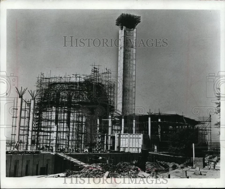

1965:
Press Photo Nuclear reactor of American Machine & Foundry Co. in Islamabad

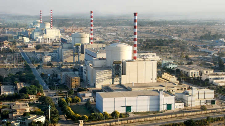

Chashma Nuclear Power Plants Complex.
